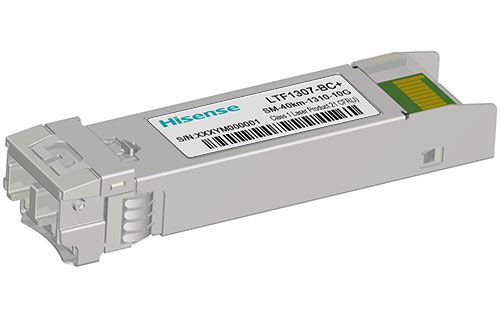

LTF1307 SFP+ Optical Transceiver
10G Ethernet 9.953 to 10.3125Gb/s 1310nm 40km
The LTF1307 SFP+ transceiver is intended for 40km reach service from 9.95Gb/s to 10.3125Gb/s with 1310nm single mode high-speed communications equipment where low-cost, extraordinary performance and reliability are essential. It consumes low power, operates from a 3.3V DC power supply and is offered in the commercial temperature ranges. They are compliant with IEEE802.3ae 10GBASE-ER/EW , SFF- 8431 and SFF-8432. The low jitter and low bit error rate optical assembly features a 1310nm DFB laser transmitter and APD/TIA receiver. It incorporates the SFP+ MSA LVTTL Loss of Signal (Rx_LOS), Tx Fault (Tx_FAULT), MOD_ABS and Tx Disable (Tx_DIS) monitor and control functions. The differential AC coupled Tx and Rx data interfaces are CML compatible. The device is Class I laser safety compliant.
