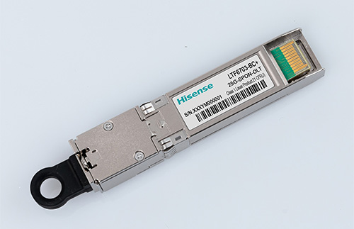

SFP28 25GSPON OLT Transceiver
The LTF6703 is intended for 25GSPON OLT DEMO in an SFP28 housing. It is using an 1358nm 25.781Gbps&24.8832Gbps downstream transmitter and a 1260nm-1310nm 25.781Gbps&24.8832Gbps upstream receiver which work in TDM configuration. The transmitters can be controlled by the LVTTL Tx_DISABLE function and the receivers incorporates the LVTTL Rx_LOS output.
The LTF6703 is designed to support up to 32 subscribers over distances of up to 20km in the ODN. It meets the EEC Directive 2015/863/EU for RoHS compliance
