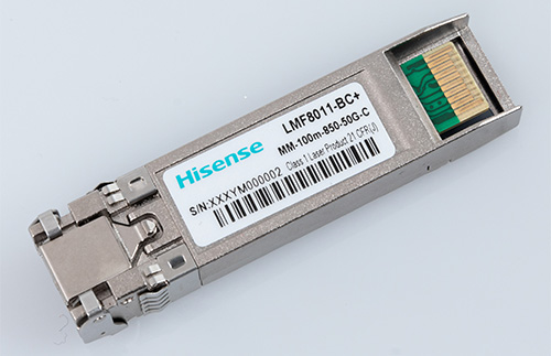

LMF8011 SFP56 Optical Transceiver
50G Ethernet 26.56GBaud 850nm 100m
The LMF8011 is SFP56 transceiver. It operates at 26.56GBaud and up to 100m with a 2-fiber duplex LC OM4 multi-mode fiber. It is compliant with SFF-8431、SFF-8432 and SFF-8472.It incorporates the SFP+ MSA LVTTL Loss of Signal (Rx_LOS), Tx Fault (Tx_FAULT), MOD_ABS and Tx Disable (Tx_DIS) monitor and control functions. The differential AC coupled Tx and Rx data interfaces are CML compatible.
